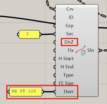

I use “KR PT 100” instead of DirZ to define local axis of SLN in Grasshopper.
But the generated SofimscC.dat shows duplicated local axis as follows
SLN NO 1010 GRP - SNO 3 DRX 0.000000 0.000000 -1.000000 KR PT 100
which causes the following error in analysis
Item at position 18 multiple defined
If a literal item to be specified is identical to the name of an item,
please quote the Literal with apostrophes
I have to manully delete “DRX 0.000000 0.000000 -1.000000” in sofimshC.dat, then everything is OK.
Is it possible to add an option “disable” to input ( in this case: DirZ) in SLN component (maybe other components as well)?
