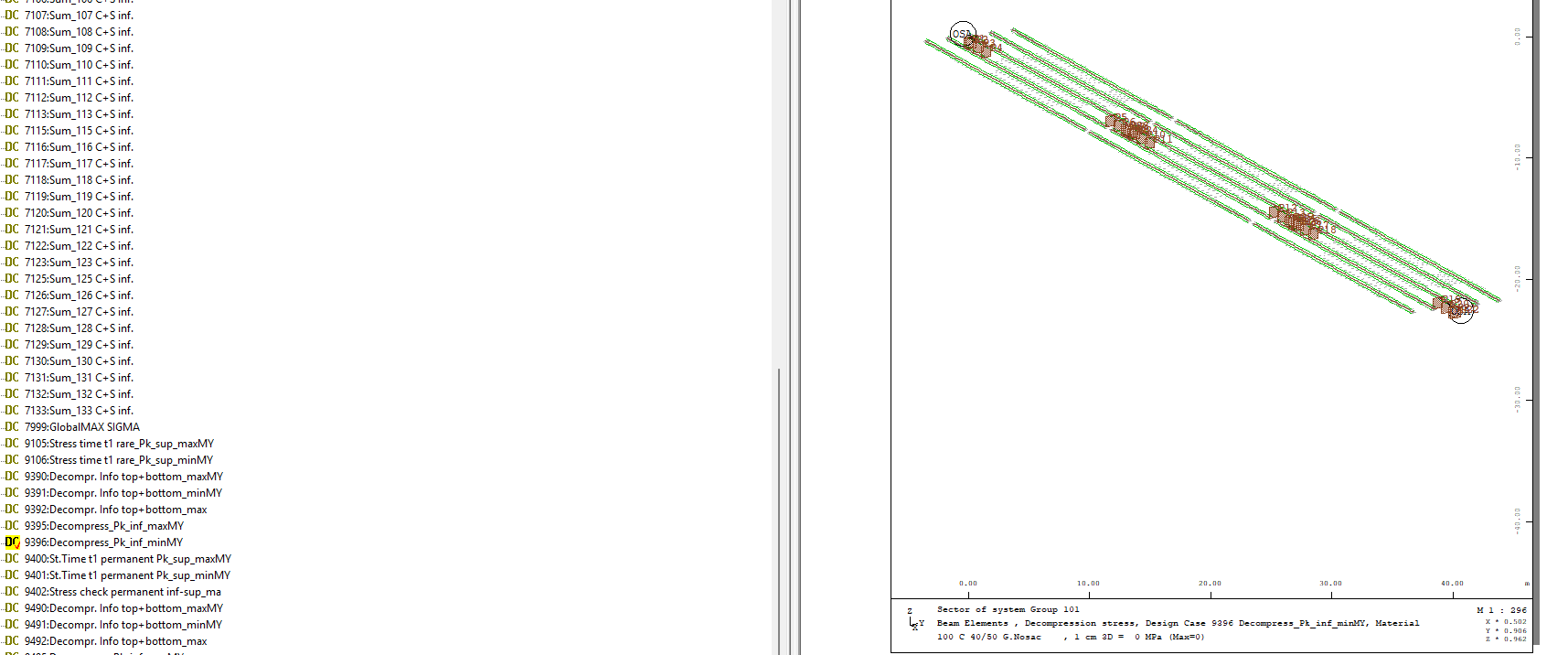

When checking decompression in prestressed T-beams, do we consider decompression stress or decompression strain? In TEDDY, I set it up so that the result is shown for LC 9397, but I can’t see the stress result, only the strain…

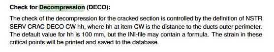

if you do the check with “nstr crac deco” only the strains will be stored in the database:
Best regards, Nora
Yes, in TEDDY there are the same code.
