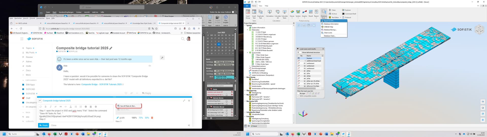

I have a question: would it be possible for someone to share the SOFiSTiK “Composite Bridge 2025” model with all definitions exported to a .dat file?
The tutorial is here: Composite Bridge - SOFiSTiK Tutorials 2025

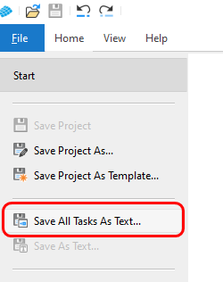

Hi Ada,
you can create you own TEDDY file.
Step 1: open the project in SSD and goto menu “File”. Select the command “Save All Tasks As Text…” Now you create a first *.dat file
Step 2: goto menu “Database Tools” and select the command “Export to Dat…”.
Now a new *_exp.dat file with information direct from the database is created.
Step 3: Combine both *.dat files and create only one single file.
Please note I would not recommend to do that. SSD and the graphical workflow provides many advantages for the user. One big disadvantage of creating a *.dat file als described above is the fact, that you will loos all parametric from the graphical workflow.
As you might not know, most of the SSD tasks write a *.dat file in the background. You may use the rightclick menu “Text Editor” and see the input created from the task. → This is a very good workflow to compar Task input with TEDDY input ![]()
Hope this will help.
