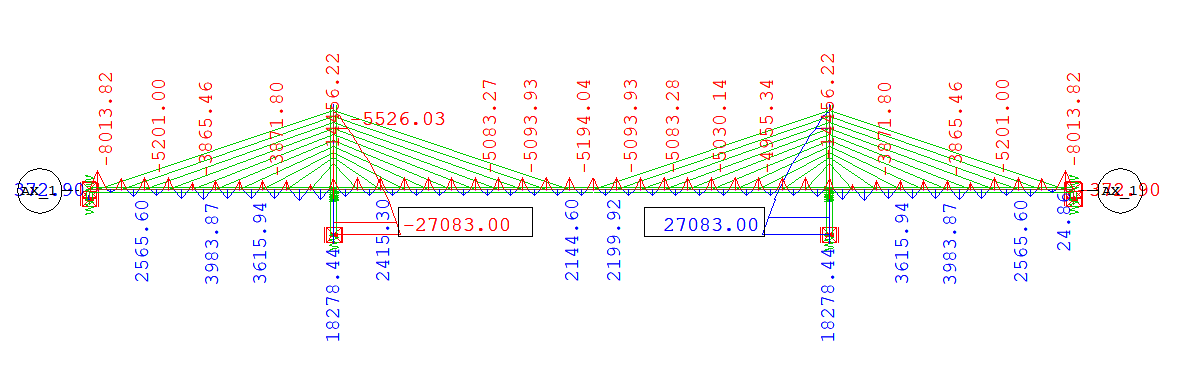

In the official Sofistik example ’impossible_targets_2_staged.dat“ (C:\Program Files\SOFiSTiK\2025\SOFiSTiK 2025\csm.dat\english\optimize\more_opti)
The moments along the girder are good (max=8000kNm), but the max moment in pylon is way too big (27083 kNm).
Is this a good example for Cable Force Optimization?
Deck optimization great, pylon optimization not really.
However this is just an example of possibilities, no real case
