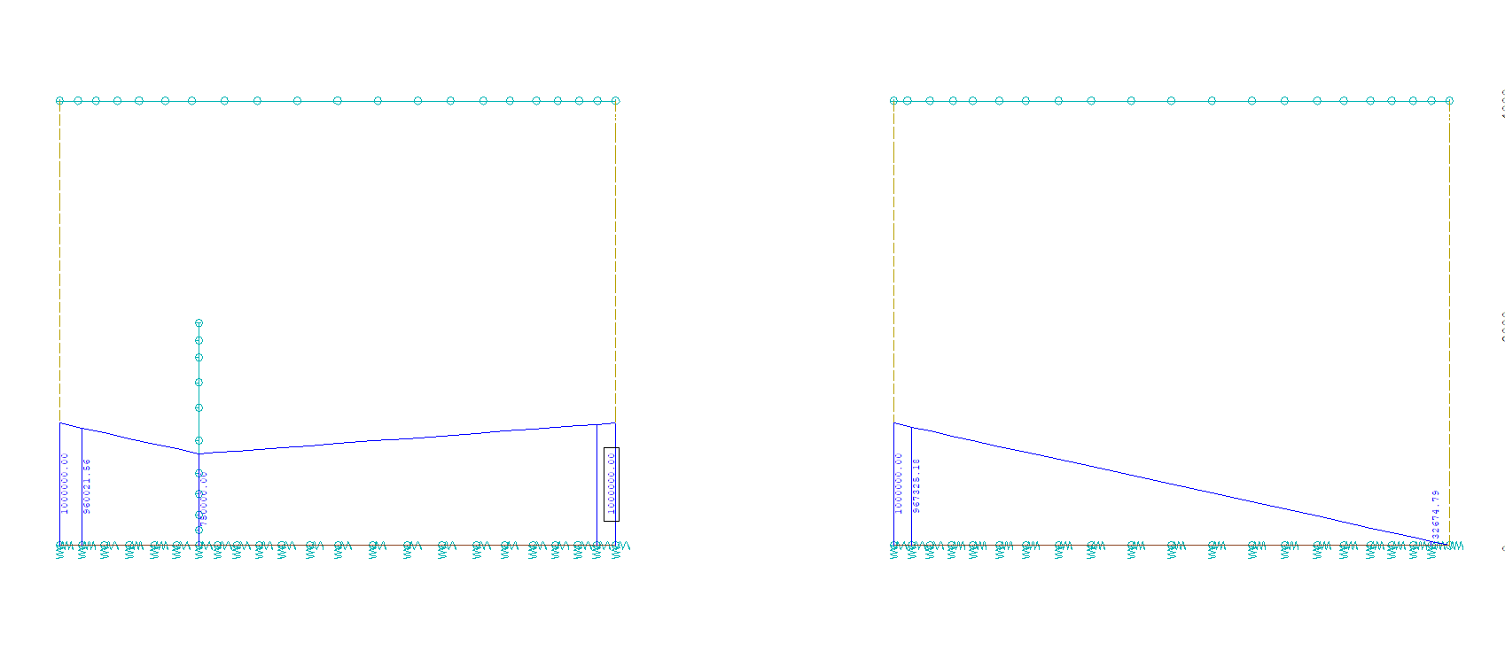

There seems to be a bug related to the stiffness of support lines. If I want to give a support line a varying stiffness along the line I can use the factor at start and end of the support line:
However, this is not correctly applied if there is another support line crossing the initial one:

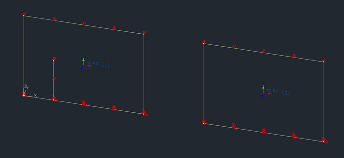

I have greated a simple example and attached the files:
Support line bug.sofistik (23.1 KB)
Support line bug.dwg (44.5 KB)
