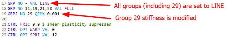

When performing nonlinear calculations in the ASE program on a model that contains elements with orthotropic behavior, which have been modified using the GRP2 command to adjust transverse stiffnesses, an error occurs, and the calculations are stopped. The error is as follows:
This happens even though the GRP command is used to set these elements’ behavior to LINE.
The workaround at the moment is to downgrade to version 2025-2 where everything works fine.

You can use an alternative solution for the orthotropic behavior: define the slab with Tx = 1 mm and Ty = the actual thickness to avoid using GRP2 in ASE.

really this error message is new. If you do not have timber quads and the group is switched linear this error should not come - we correct this. But you can also use actual version and input in ASE : CTRL WARN 893.
Thank you for this hint.
