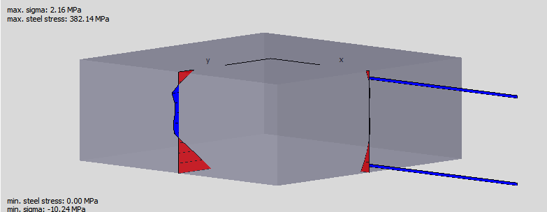

But this is the output:
I misunderstoof the manual.
This is the correct code that gives reinforcement in both directions, both layers.
GEOM - HA 53 DHA 16 HB 53 DHB 16 $ Expositionsklasse XC1
DIRE UPP 90 LOW 90
PARA NOG - DU 20 ASU 13[cm2/m] 13[cm2/m] DL 20 ASL 13[cm2/m] 13[cm2/m] WKU 0.30 $
