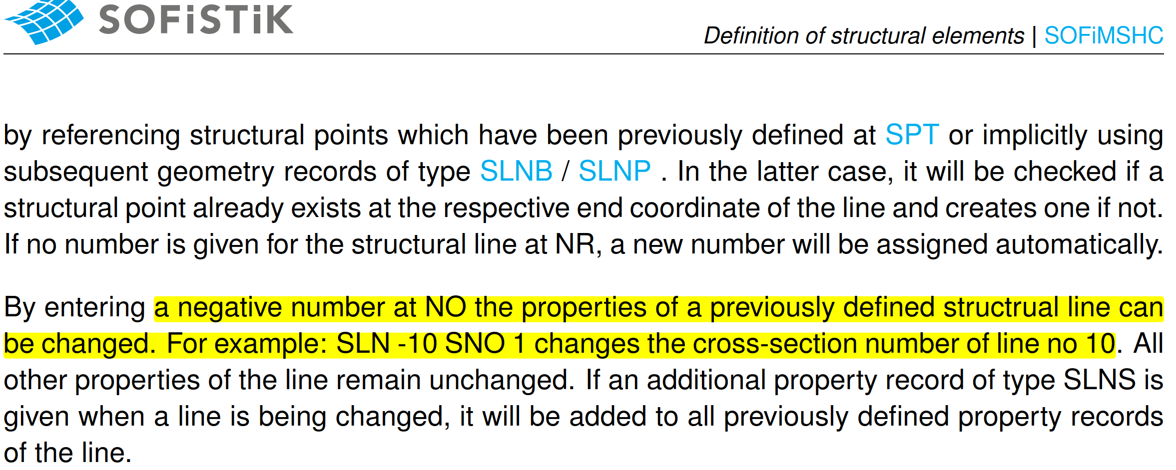

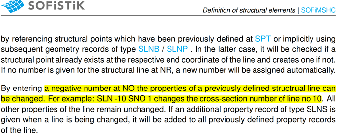

And how could I call this SLN to change its Cross section? If I call the specific SLN No in a new Sofimshc, I get an error that this structural line number already exists.
Sometimes there are such strang things like manuals:
