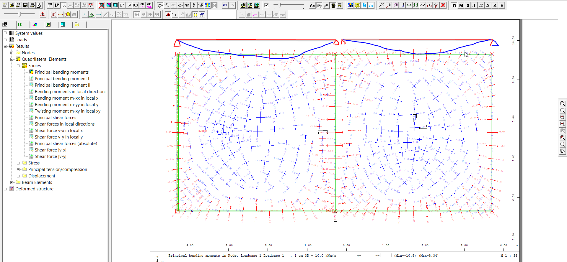

Hello everyone,
How I can break the continuity in -ve BM of the attached slabs.
I want the two attached slabs as simply simply supported not continuous.
Thanks
if you work with SOFiPLUS, use the Area Edge Properties:
https://docs.sofistik.com/2025/en/sofiplus/cmdref/se/createmodify_area_edge.html
If you work with SOFIMSHC, use FIX in the sentence SARB (see page 5-30 in user manual for version 2025).
