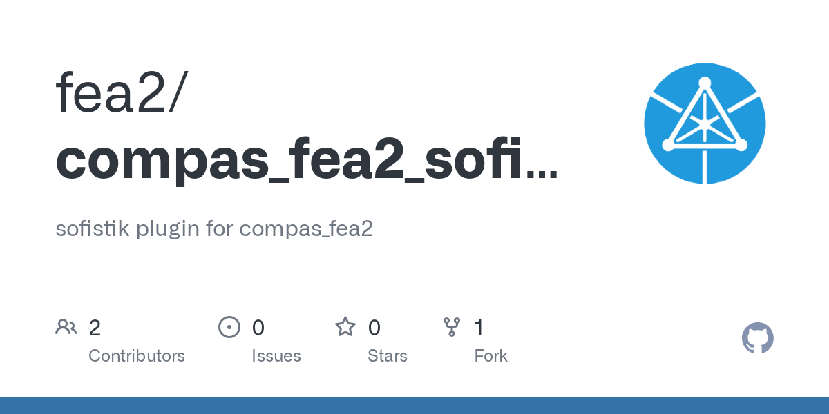

Maybe compas-dev is something for you. You can create designs with python. Not Lua unfortunately though.
There is also a plugin for Sofistik.
I haven’t tried it out myself, but I am very curuous about the experience of others in terms of functionality and ease of use.
